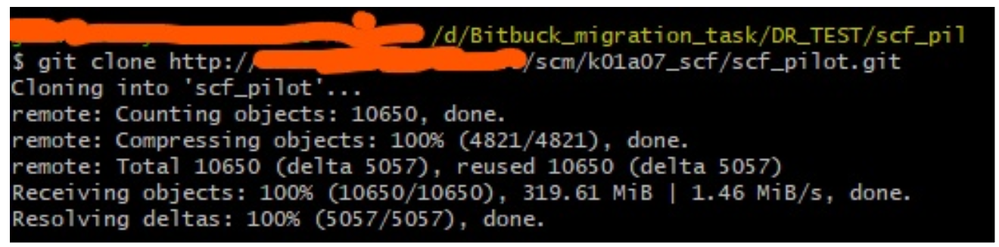

git clone seems to be completed but there are no contents in local
git clone <bitbucket-repo-url>
Cloning into 'new-folder'...
remote: Counting objects: 104495, done.
remote: Compressing objects: 100% (39290/39290), done.
remote: Total 104495 (delta 55182), reused 104298 (delta 55118)
Receiving objects: 100% (104495/104495), 85.77 MiB | 1.89 MiB/s, done.
Resolving deltas: 100% (55182/55182), done.
.git folder is being created during the process of git clone but by the end of clone, it is getting deleted automatically.
How to solve this ?

Hi @Ana Retamal
We are still facing the issue.
After the syncup of repositories from production server to DR server, git clone is not working for few repositories in DR server.
All the operations are working fine in production server.
Below is the bitbucket log of DR server.
https://github.com/jash1th/BB_COMM.git
