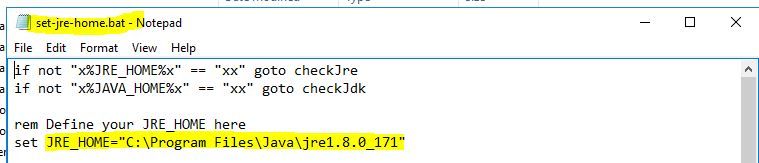

I am issue is like below.
It gives an error that.\bin>start-bitbucket.bat
JRE_HOME "C:\Program Files\Java\jre1.8.0_171" contains spaces
Change to a location without spaces if this causes problems
But the applications start this manual way.

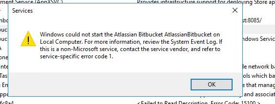

But if we go to windows service it doesnt.
Attached screen shot for reference.Any help would be highly appreciated.

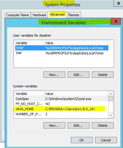

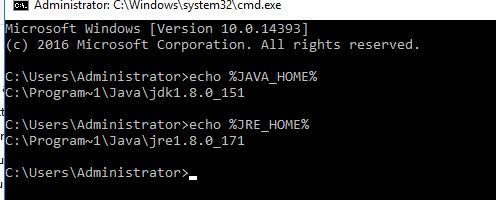

After reviewing your logs, the one mistake i see that could be causing your service stoppage is the spacing in the java home path.
Please make sure that the environmental variable is defined as follows:
C:\Progra~1\Java\jdk1.8.0_51
Also, make sure that you are targeting the correct Java home folder. What tends to happen is that Java auto updates and then points to a new directory. Make sure your jdk is pointing to 1.80.51
Let me know how that goes
CrownConsult
November 6, 2018
I have done changes as advised and its still the same.
Attached few screen shots and logs.
This error shows that its pointing to wrong directory.Where to change that?
"Failed creating java c:\program files\java\jre1.8.0_151\bin\server\jvm.dll"

Have you changed it in the systems configured environment variables as advised?
You will find environment variables by right clicking computer, properties, advanced settings. You should have an environment variable listed there for your bitbucket installation i.e.
C:\Progra~1\Java\jdk1.8.0_51 or the latest Java update present on your system.
If the environment variable does not exist, you need to configure one.
Let me know the outcome.
The logs you provided all state a path cannot be found. So either your environment variable is not defined or it has that added space we discussed which needs to be replaced with the
~ or the variable is missing all together or pointing to your previous JRE install

I have tried all possible solutions.if I change the Varialble it doesn't start manually also.
So kind of stuck now and not sure what has been to done.
