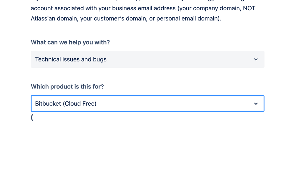

Trying to open a ticket butt am stuck here. I need to demo to a client and don't have backups locally. This could be a huge huuuge disaster worth many years of hard work :-(

when I realized this happened to me, I opened a ticket on https://getsupport.atlassian.com/servicedesk/customer/portals
They were pretty helpful, and they did have a backup of all my stuff, which they sent me.
