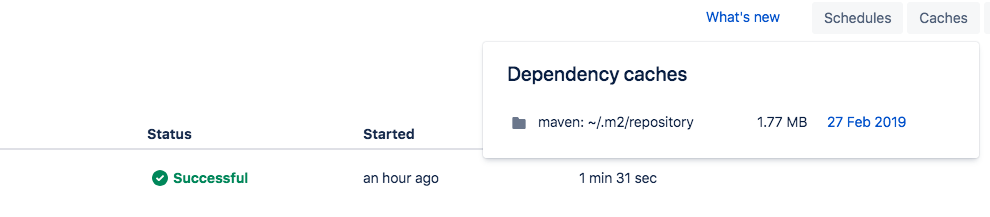

Some problem with the cache as it is not updated and stuck in 1.77mb, I deleted the cache and run again the cache went up to 70+mb. now cache is loaded

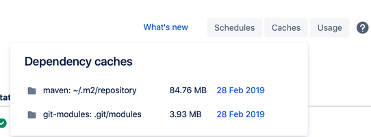

Please try moving caches as your first step.
Do you see caches as shown? Have you had a successful build?
cdov
February 28, 2019
Screen Shot 2019-02-28 at 12.57.22 PM.pngthe build is sucess, by the way i am using maven 3.6.0 image
