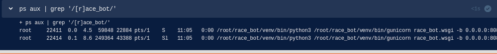

I use awk command  to parse pid of my server process. So i have next command with its output:изображение.png

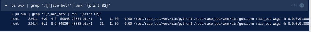

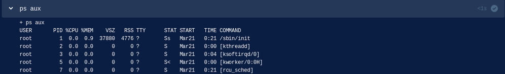

But it does not work. To know reasons of it i gизображение.pngo step back:изображение.pngизображение.png
Here we can see, that awk statement have no affect result.

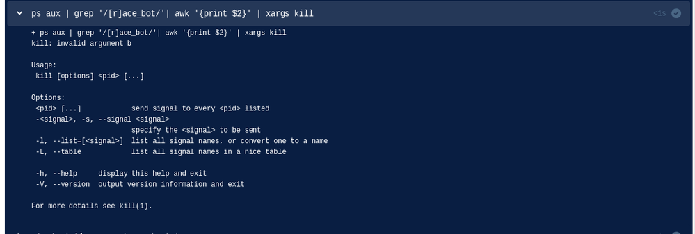

изображение.pngSo how cann i solve this issue? What i am doing wrong?

Can you double check the output of "ps aux | grep '/[r]ace_bot/' | awk '{print$2}'" on Pipelines? You've got everything else to compare except that at the moment.
Philip Hodder
April 5, 2018
Also you may wanna check that your PIDs are still output as expected if you use:
ps aux | grep '/[r]ace_bot/' | awk '{print $2}' | xargs echo

Actually. The 'print $2' doesn't seem to be working as expected here. That seems like a candidate.
