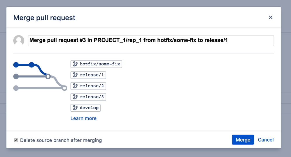

I've checked the behaviour of Bitbucket Server and found that if your configuration is roughly like this:

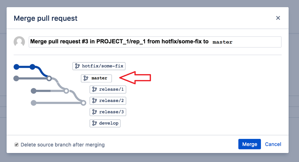

Then the resulting automerge will look something like this:
Note that it does not merge into the production branch (master) here.
This is intended behaviour as explained in BSERV-9740 because our interpretation of GitFlow is that merging changes to master is an explicit step should be taken only when a new release is cut.
In the case of a hotfix, you're likely going to want to cut a release straight away - but the timing of when that happens is up to you and shouldn't be dictated by a tool. For all Bitbucket knows, you may have multiple hotfixes that you want to release at the same time in which case you would wait for all of them to merge to develop before merging to master to cut the release.
