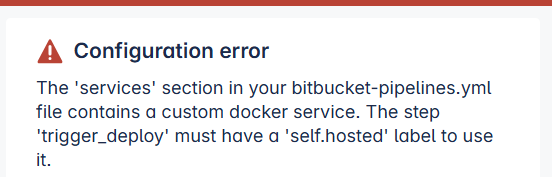

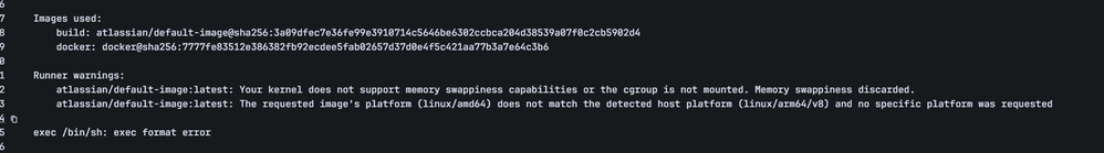

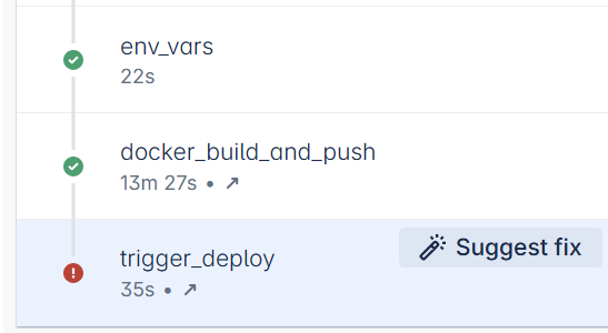

Having a problem when using the pipe atlassian/trigger-pipeline:5.3.0 on self-hosted runner on arm64.
Tried use the cloud runner for the step but being forced to use the self-self hosted
What I was expecting, it shouldn't be forced to use self-hosted as I didn't declare any service on the trigger_deploy step, or at least support arm64 as well.

1. The pipe atlassian/trigger-pipeline supports arm64 as of version 5.8.1:
The latest version of the pipe at the moment is 5.10.0. You can use the latest version, 5.10.0, and the pipe should run in an arm environment.
2. The second screenshot you shared has a warning about the platform of the Docker image atlassian/default-image:latest. Please keep in mind that the tag latest is currently using version 1, which is a very old version of this image. The reason that the tag latest is using 1 is to keep compatibility with existing Bitbucket Pipelines builds.
Support for arm has been added to atlassian/default-image:4 and atlassian/default-image:5.
3. With regards to the last screenshot in your post: a pipe starts a separate Docker container, so a step that uses a pipe will use a Docker service even if you haven't defined one explicitly for the step.
If there is a definition for a Docker service with a custom dind image in your bitbucket-pipelines.yml, then Pipelines will use that definition for a step with a pipe. You will then see the error you posted because a cloud-based pipeline cannot use a custom dind image unless you use runtime v3.
If you want to run this step on a cloud runner, you can:
Please feel free to reach out if you have any questions!
