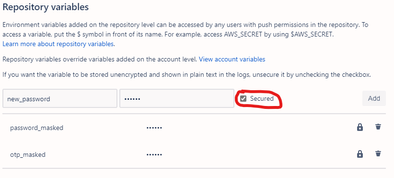

In regards to your question about masking the repository variables, you will need to tick the "Secured" checkbox when you create the variable.
Sample Image:
Once you created the "secured variables", Pipelines will check if the display output matches the variables' value.
If it matches, it will replace it with the variables name such as below:

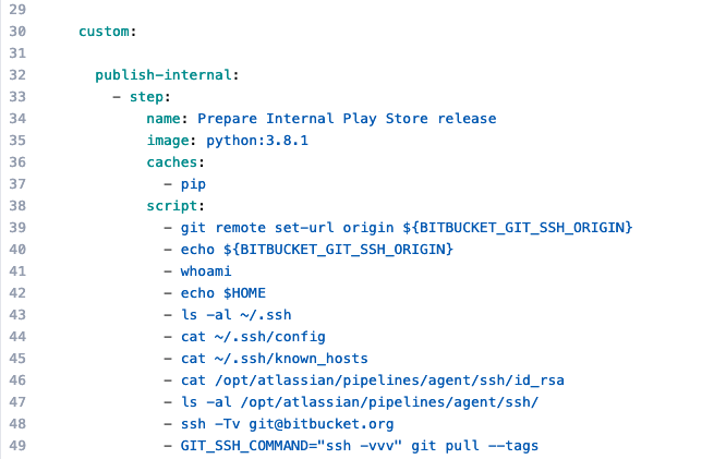

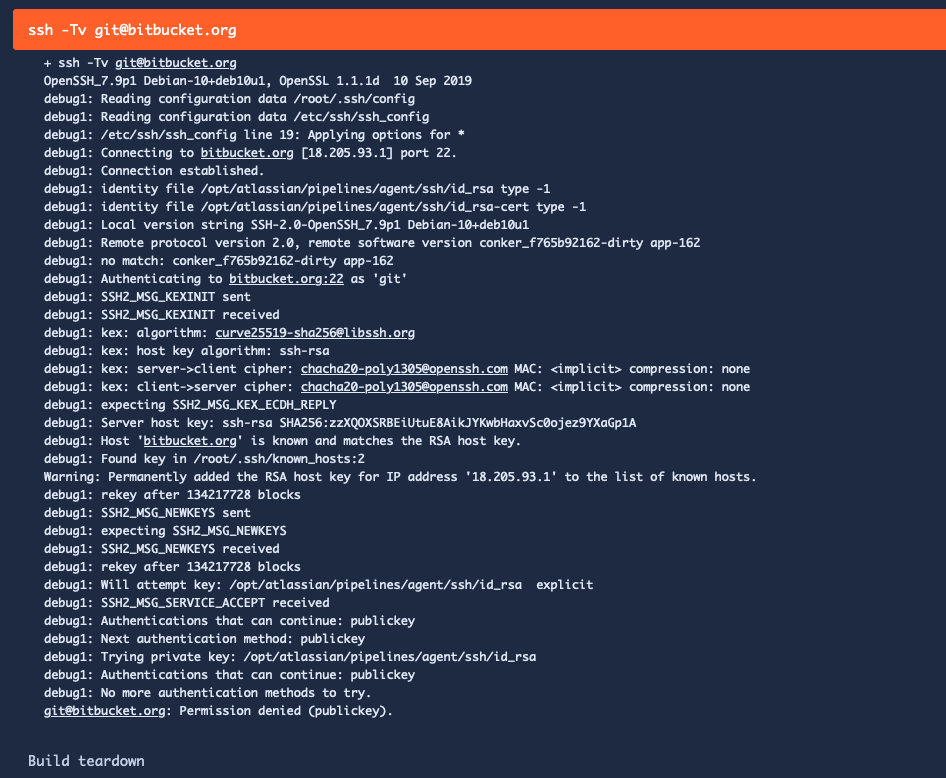

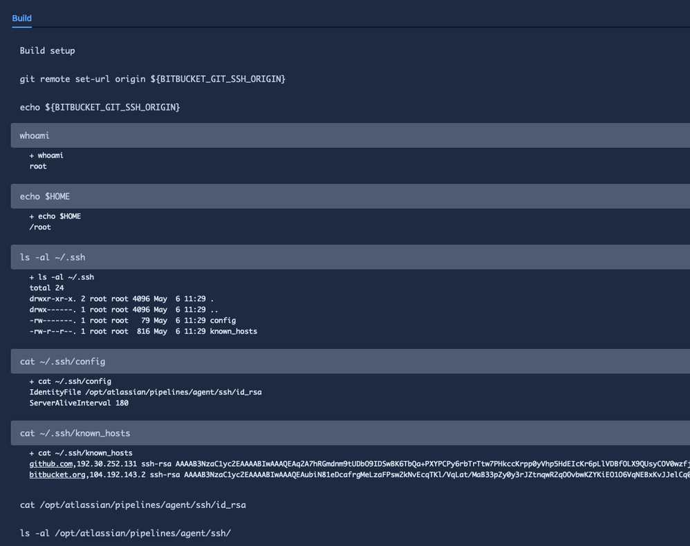

I've now gone to the point of removing the repository variable that I thought was causing the problem and letting Bitbucket generate my SSH keys and I'm doing a dirt simple pipeline like the example you gave. And still, errors.
Screen Shot 2020-05-06 at 6.36.15 AM.pngScreen Shot 2020-05-06 at 6.37.11 AM.pngScreen Shot 2020-05-06 at 6.37.25 AM.png
