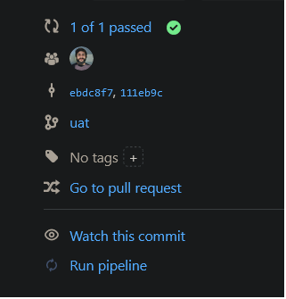

Is it a bug or some kind of rule that I don't know but when I manually run a pipeline on a past commit for a second time (on the same commit that initiated the pipeline, and ended up with a successful build and deployment afterwards), build step fails with the message "bash: [: ==: unary operator expected", but as if it wasn't error to fail the pipeline. Likewise, the same error happens if I try to run the pipeline manually on commits that've not started the pipeline because I've made another commits later on. Why is that?

No, we use Bitbucket servers; there're some steps that triggers something else in remote machines, but those also give the same message without taking any action set in pipelines; so, I believe this relates to Bitbucket anyway. Actually, there's no need to open a ticket or anything; just go to commits from the left bar and click run pipeline button as in the image below, which'll give the same error.
But I need to make an UPDATE on my initial query: running the pipelines on a commit that's successfully initiated and completed pipelines is still OK (I probably misinterpreted my test results); however, running the pipeline on a commit that's NOT initiated a pipeline (because there's been other commits after it, and then final push to initiate the pipeline), fails or gives this message and acts as if it was OK

May you please confirm that you've tried to initialize a pipeline on a commit after which another commits have been made? I rigidly, and maybe annoyingly, keep asking that because I can reproduce the error. Here's the error log you've asked:
