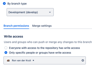

When I set the restrictions like this:
I still get the following error:

For Pipelines, it doesn't matter which user triggers the pipeline. This is irrelevant when you do a git push from Pipelines to a branch with branch restrictions. If you want your Pipelines build to do a git push to a branch with branch restrictions, you'll need to configure authentication for this push, with a user that is added to the branch restrictions.
Additional info on how to make this configuration is on the page I shared in my previous reply:
Possible ways to do that are explained in the following documentation, specifically in the sections SSH Key pair managed by Bitbucket Pipelines, SSH Key pair managed with variables, App secret:
The three sections I mentioned are three different ways of configuring authentication for pushing from Pipelines.
Please be mindful that the username and app password of a user can be used to retrieve all repos a user has access to and SSH keys grant access to other repos this user has access to. You could use a separate user (that would serve the purpose of a bot account) that has limited access.
If you have any questions about the info on this documentation, please feel free to let me know.
With regards to SourceTree, the message typically occurs when branch restrictions are in place. I suggest checking the user authentication you have configured in SourceTree.
Based on the screenshot, I assume you are using SourceTree for Mac. First, open the repo in SourceTree, select the button Settings (top right corner) > select the tab Remotes and in there, check if the remote repo URL is an SSH or an HTTPS one.
Then, in the main SourceTree window (where the list of your repos is displayed), select the arrow next to the three dot circle > select Accounts. Edit the details of the account added there, and confirm (a) that the protocol matches with the protocol on the remote URL of your repo and (b) that the authentication details in there are for your Bitbucket user. If you use the SSH protocol, please ensure that the public SSH key that SourceTree is using, is added to your Bitbucket account here: https://bitbucket.org/account/settings/ssh-keys/.
Just a heads up, I removed the screenshot from your post to protect your privacy, as it was showing your repo details.

1. Please double check that the Pipelines SSH key was generated in the repository where you run the build that does a git push (and not in a different repository). If that is the case, then that part is correct.
2. Please double check that the development account where you added the public SSH key is allowed (in the branch restrictions) to write to the branch you want to push.
The screenshots from the branch restrictions you shared earlier shows that only your Bitbucket account has write access to the branch. However, your account doesn't have any SSH keys.
You will need to do one of the following:
  • either remove the SSH key from the development account and add it to your account
  • or, if you want to keep the SSH key to the development account, then allow this account to write to the branch via branch restrictions
3. If the two points above are ok, you will then need to adjust the bitbucket-pipeline.yml file of the repo that does a git push, and add this command before the push command:
- git remote set-url origin ${BITBUCKET_GIT_SSH_ORIGIN}
This command is necessary so that the push command will use SSH and authenticate with the SSH key.
