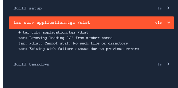

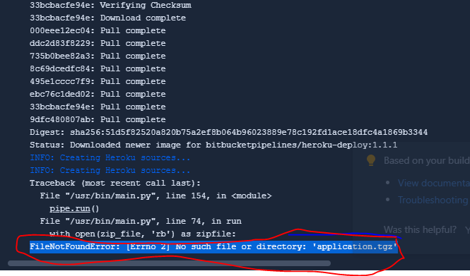

srinu ch
July 20, 2019
image.pngHi I got above error, while running Create artifact step.
Could you please help me on this. Where is my dist folder created and which path i have to mentioned.
Alexander Zhukov
July 22, 2019
You should remove the leading slash from the /dist, otherwise tar will try to look up the dist folder relative to the root directory. You should use either dist or dist/ (with a trailing stash) to specify the directory relative to the build directory. Note, that the build directory is not a root directory inside the pipe container.

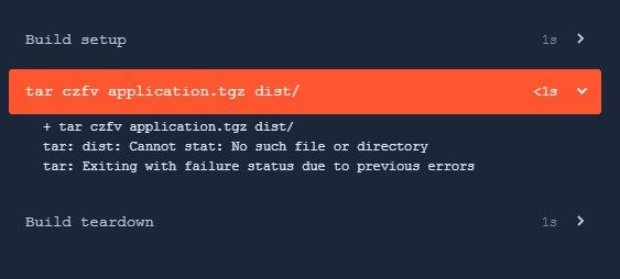

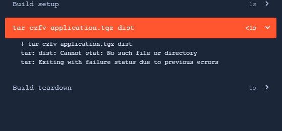

srinu ch
July 22, 2019
Screenshot_2.jpgScreenshot_3.jpgI tried both but no luck
Alexander Zhukov
July 25, 2019
This is weird. What is the path to the dist folder? And how do you create that dist folder with the minified code?

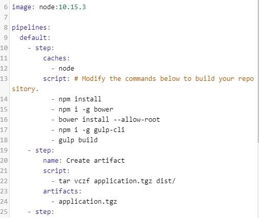

srinu ch
July 26, 2019
Above one is my .yml file.

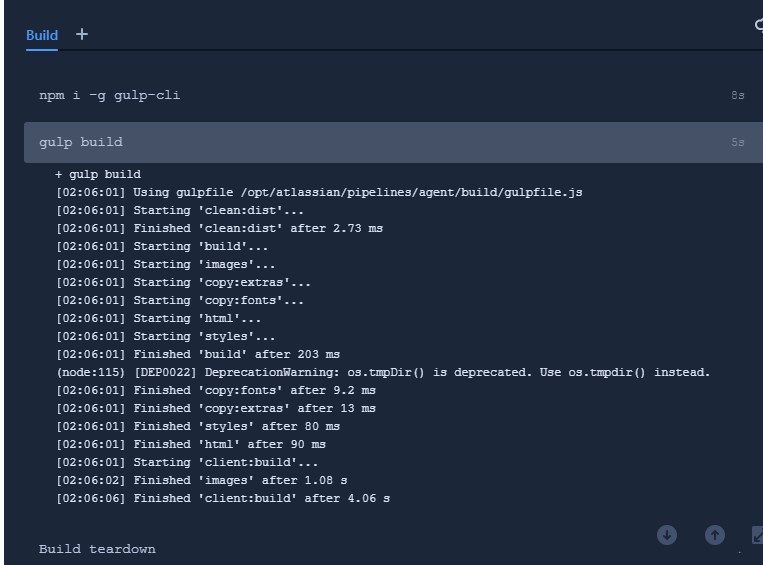

This is my build success reportbuild.jpgafter completed gulp build , it creates dist folder with minified code,  But  i don't know the exact path .So could you please help me , where it was created.
Alexander Zhukov
July 29, 2019
Ok, I see what's going on. Since you're building your app in a separate step, you should also expose you dist folder as an artifact so the next step can access this folder to create a tar.gz file:
-step:
caches:
-node
script:
- npm install
- npm i -g bower
- bower install --allow-root
- npm i -g gulp-cli
- gulp build
artifacts:
- dist/** # this will make sure the dist/ folder is available to the next steps

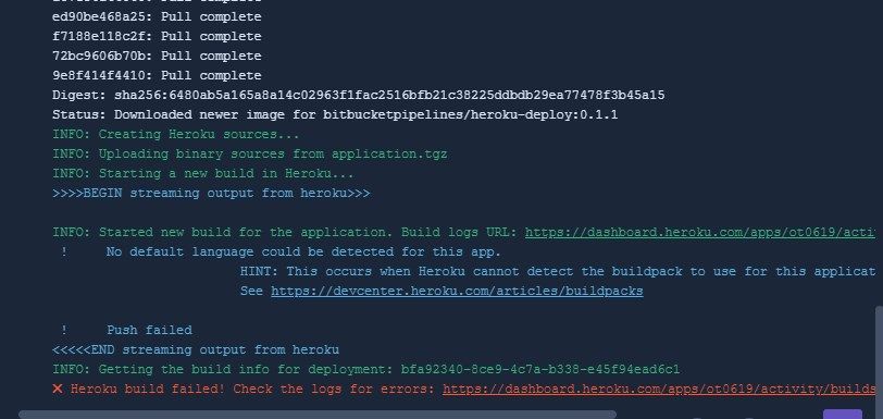

srinu ch
July 29, 2019

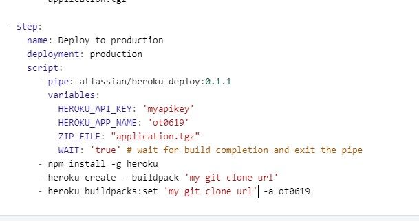

Now dist folder recognized, but while pushing source code from bit bucket to heroku, the deployment is going to fail.build.jpgbuild2.jpgCould you please help on this.
Alexander Zhukov
July 30, 2019
@srinu ch as logs from Heroku inform, it can't detect the buildpack automatically. Mostly likely, you should run the pipe after you set the buildpack for an application. Try moving the heroku create --buildpack and heroku buildpacks:set commands up in the script so they are executed first.
