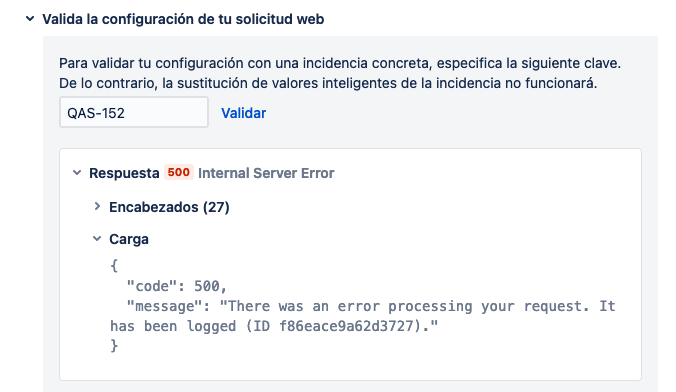

I have a task in jira, and I want to use a automation rule.
With this rule I want to run a pipeline in bitbucket.

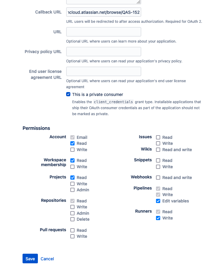

I create an oauth consumer in the repository, but when I generate an access token and make the post request I get and status code 500.
Captura de Pantalla 2022-06-10 a la(s) 13.07.22.pngCaptura de Pantalla 2022-06-10 a la(s) 13.06.52.png

Hello @Mauricio Mondragon ,
Thank you for reaching out to Atlassian Community!
With regards to the call-back URL, it's only really needed if you are using an OAuth flow that involves a web browser. From my understanding, you are trying to build an automation in Jira that just involves API calls, so you can put any URL as the callback URL such as https://localhost or https://bitbucket.org, as it will not impact the token that will be provided.

In my automation rule I´m send web request to this url
My headers are
Content-Type application/json
Authorization Bearer + token
I tried generating the token by client credentials and Authorization code, but the status response is 500 by this methods.
My body request is:

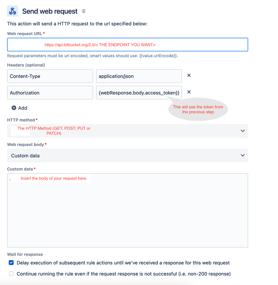

2. Call the Bitbucket API endpoint providing the access_token from the previous step
You need to use the access_token you got in the step above to authenticate the call to Bitbucket API endpoint you want, as the following example :
The parameters are :
URL: https://api.bitbucket.org/2.0/< Endpoint >
Headers :
Content-Type : application/json
Authorization : Bearer {{webResponse.body.access_token}}
Could you please try configuring as the suggestion above and check how it goes?

I followed your instructions and it works for my automation rule.
Now when I request run a pipeline I get a successful response.
Thanks for your help. This was very helpful.
