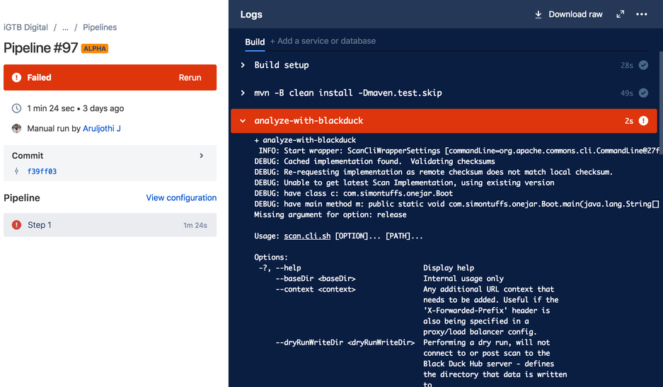

Screen Shot 2018-05-31 at 1.15.37 PM.pngThanks for your response Jeroen.
I would like to elaborate my issue here.
#Blackduck is opensource security scan software, when I run my pipeline with "analyze-with-blackduck" it will scan my branches(master/develop/future) and create/send report to blackduck server.
"analyze-with-blackduck"-this is the command which I am using for my branch scanning.
It will scan for master/develop/future branches not for TAGS.
We had a shell script to detect and scan the branches not for tags, now I am trying to scan Tags also but it's shows error.
I have updated my pipeline.yml and script:
image: :my-java-image-v1
pipelines:
tags:
   release_*:  #this is using for each new release.."*" is the issue.
     - step:
        caches:
           - maven
       script
      - mvn -B clean install -Dmaven.test.skip
     - analyze-with-blackduck . #This is a cmd for blackduck scanner
 Below pipeline is using for develop, it's working
image:my-java-image-v1
pipelines:
develop:
     - step:
        caches:
           - maven
       script
#We mentioned scan information on docker image.
Script:
$BITBUCKET_BRANCH=${BITBUCKET_BRANCH:-$1} #working
$BITBUCKET_TAG=${BITBUCKET_TAG:-$1} #not working
echo $BITBUCKET_TAG
echo "TAG"

Aruljothi J
May 31, 2018
I am facing issue with BITBUCKET_TAG, when I am trying to scan my tag branch using blackduck software it will show "missing argument" issue.Some one please help me.
Jeroen De Raedt
May 31, 2018
Hi @Aruljothi J,
might be best to create a seperate question for this, since it is a different topic.
Regarding your question, I am not entirely sure what blackduck software does, but keep in mind that the $BITBUCKET_TAG variable will only be set if you pushed a tag (i.e. not if you pushed a branch reference).
