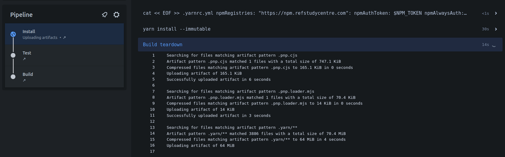

Some of the uploads succees, but the web interface keeps waiting on this screen until some kind of timeout is exceeded (which seems to be much longer than the max-time of 10 minutes that I set for the specific step):
Here is the relevant part from the appropriate runner.log (slightly redacted): https://pastebin.com/ddYznXg3
To help you correlate the logs with my screenshot: The web interface output was stuck at line 16 (Uploading artifact of 64 MiB)from around 2024-11-07 12:24 to 2024-11-07 12:42. It finally showed the failure around 12:42

Ersa Rizki Dimitri
February 24, 2025
i'm experiencing this issue also. failing when step build teardown uploading artifacts.
using runner mac os 3.16.0.
any update? what should i do?

I am using a Windows self-hosted runner, and keep `getting Error occurred whilst processing and artifact`.
My pipeline uploads several artifacts successfully, then my last artifact is large (590MB), but the log says no errors, but this artifact is missing from the artifacts page. It fails in ~1min, so not hitting a 10 min timeout. This has been working for months, but recently started failing.
Bitbucket please give us more useful errors.
Compressed files matching artifact pattern <redacted> to 597.2 MiB in 18 seconds
Uploading artifact of 597.2 MiB
Searching for test report files in directories named [failsafe-reports, TestResults, surefire-reports, test-reports, test-results] down to a depth of 4
Finished scanning for test reports. Found 0 test report files.
Merged test suites, total number tests is 0, with 0 failures and 0 errors.
