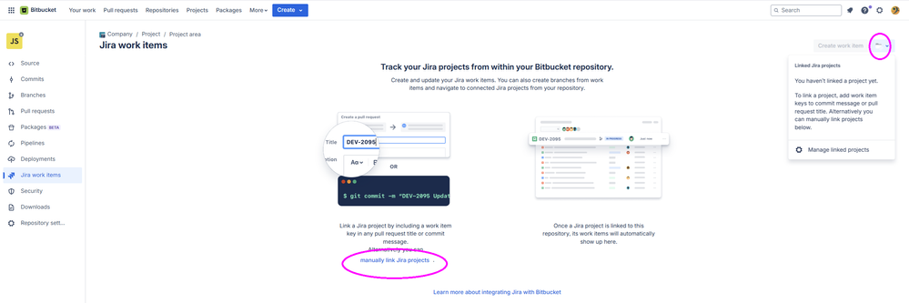

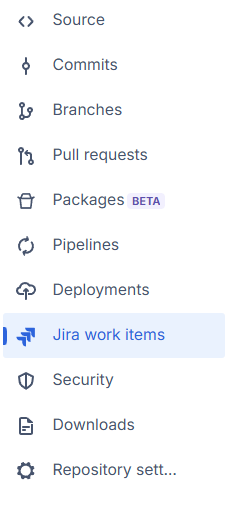

    After an integration, on the left side panel will show an item called Jira work items. It looks like this:
In the center or top right, add a manual link project from the drop down, after that, the issue tracking shows back up. You just follow the steps of selecting the Jira project to it and he issue tracking returns. You just need to remember to add the TODO in your source code to easily link it with the Jira bug, feature, or task.

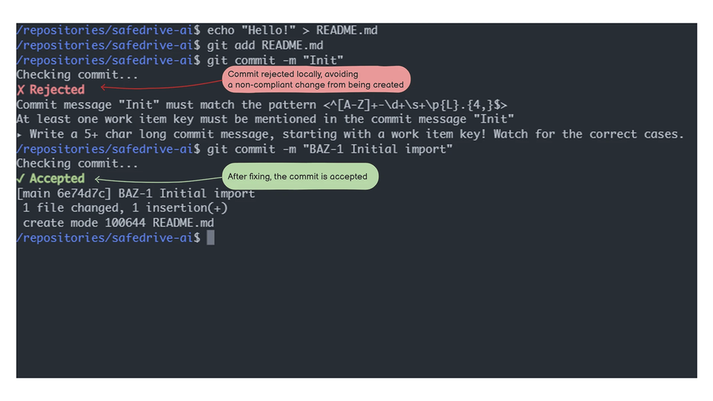

 In the meanwhile we have developed something that closely relates to linking code changes to Jira bugs, features, tasks in a controlled way. "Controlled" also means that your developers don't forget it.
Our Better Commit Policy Connector is a Bitbucket app that enforces developers to enter a work item key  to every commit message. If they forget it, the commit won't be created, the changes are still staged, so they can commit it correctly then:
It works very well with AI powered workflows, too! It won't allow the AI to create commits without the corresponding work item reference.
