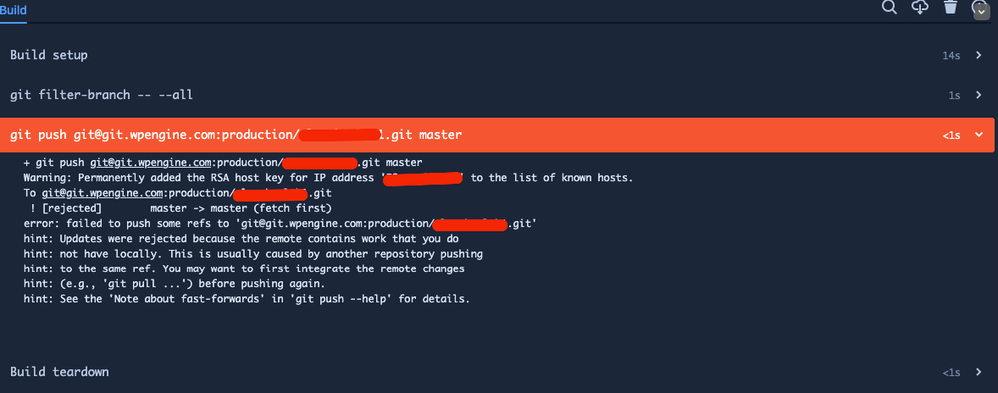

Thank you for your answer. Removing --force sadly results into a failed deployment. I'm using this document from WPengine to configure the deployment: https://wpengine.com/support/deploying-code-with-bitbucket-pipelines-wp-engine/.

The first question I would like to ask is whether you are pushing changes to master branch of this WPengine repo from elsewhere, e.g. if there is anyone from your team or another Pipelines step, or if you have a script or tool that pushes to master branch of this repo. This is one possible cause for this error.
If the above is not the case, i.e. if only this Pipelines step pushes to master, then I suspect the command
git filter-branch -- --all
may be the culprit. I have tried testing your scenario by pushing to another Bitbucket repo, as I don't have a WPengine repo to test. Bitbucket repo 2 where I was trying to push is a fork of the repo where I was running Pipelines. Push without --force would fail when the above command was included in the yaml file, but it would succeed without it.
Is that command necessary for WPengine? I don't see it in the guide you linked here. My suggestion would be to try removing the above command, and also do a full clone in your Pipelines step, as I believe it is needed for pushing to the WPengine repo, see here: https://community.atlassian.com/t5/Bitbucket-questions/Pipeline-issue-with-wp-engine/qaq-p/1667433
