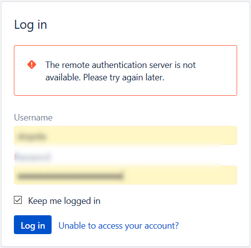

i am upgrading from bitbucket 5.14. After the upgrade I can only login using a local account. But using my active directory login no longer works. And I can’t figure out how to fix this issue.

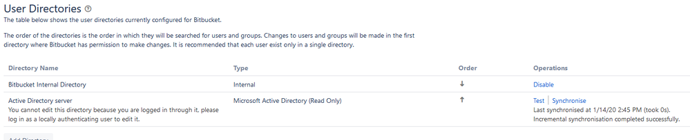

@Max MalyginThis is what we have under User Directories
No apps under Manager Apps.
Max Malygin
January 16, 2020
At first glance, everything is fine.
But since authorization does not work, it seems that a more in-depth study of the settings and operation of the instance is required. Please check the Troubleshooting and support tools in Bitbucket Server administration area - Log analyzer can help determine the cause.

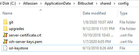

@Max MalyginAfter upgrading to 6.9 would I just be able to copy + paste these files into the new upgraded located? The image below is from our Bitbucket 5.14 version.
Max Malygin
January 21, 2020
Hi!
Perhaps this is not enough. It is required to check whether the keys (javax.net.ssl.trustStore) for using these files were saved in the new version. If they are missing, then you will need to transfer them from the old version.
Another option is also possible. Required certificates could be added to the Java repository - $JAVA_HOME/lib/security/cacerts. Then you should add certificates to the new Java repository or copy the cacerts file from the old to the new Java.
