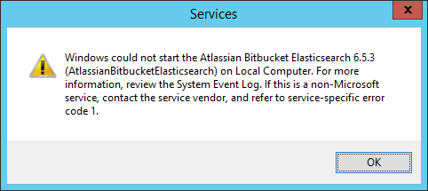

Last try was better, but can't start ElasticSearch. This is the message:
Looking into the logs for more detail.
