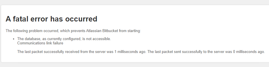

This is what I can see when connected to http://myserver:7990
