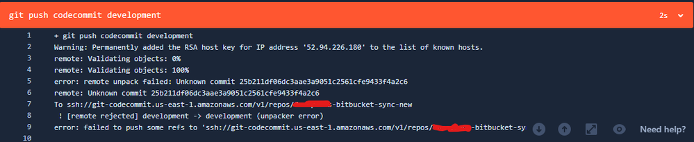

I'm unable to push the code to the codecommit repo from the bitbucket repo using the bitbucket pipeline.
Its throwing the below error. Kindly help to resolve this.

In case it is a branches pipeline, Pipelines clones by default the last 50 commits of the branch during a build. You can try specifying a full-depth clone for this step so that the push succeeds:
I've also seen other users report that the error occurs when they push from Bitbucket Cloud to an empty CodeCommit repository. If the CodeCommit repo is empty, you can try pushing first from your local machine and then see if subsequent builds succeed.

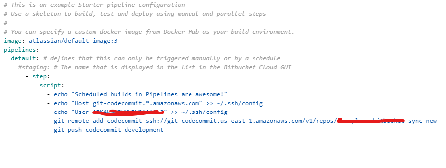

We are using the default pipeline property. FYI, I am including the screenshot of the pipeline below.
Also we have tried pushing the code for the same branch to the codecommit manually, even after that also we are getting the below error. Its showing as "unknown commit" after making changes and when the pipeline runs.
Your help in resolving the issue would be greatly appreciated !!

The default pipeline will run on a commit to every branch of the Bitbucket repo.
The git push command you have in your yml file will try to push to the development branch of the CodeCommit repo.

If the CodeCommit repo is now empty (no branches, no history), first try to push from local:
1. Take a new clone of the development branch of the Bitbucket repo on your computer
git clone -b development <bitbucket-repo-url>
2. Switch to the directory of the clone (this should be the repo name)
cd <repo-name>
3. Add a second remote for the CodeCommit repo
git remote add codecommit <code-commit-repo-url>
4. Push to codecommit
git push codecommit development
Afterwards, change the yml file in the Bitbucket Cloud repo so that:
  • the build runs only on commits on development branch (there is no need to have a default pipeline that will run on other branches, if you don't push anything from these branches)
  • the step includes a definition for full-depth clone
