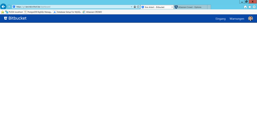

In addition, if I try to access Bitbucket on the server itself and login, the login works though the domain is redirected form the local address (localhost) to the proxy name address. But even if the login works, no content is displayed in Bitbucket: I can only view my logon and the "headline" of the Bitbucket website, like:

If I try to login with the administrative user in Bitbuckets internal directory, I am running into the problem, that the username of this user equals the username of my account in Crowd. And I have set crowd in the list of user directives at top. If I try to logon via the server itself, eg http://localhost:1 for Bitbucket and http://localhost:2/crowd for Crowd, I am able to login with the user credential set in Crowd and if I review the sync status of users in Bitbucket, I can see synced users from Crowd. But if I try to logon from any other system, eg my personal computer, I am running into the issue, that https://bitbucket.my-domain.tld/j_atl_security_check respons with eigther http/404 or http/503.2. The following screenshot shows the website (from my mobile device), after logging in from extranet.
