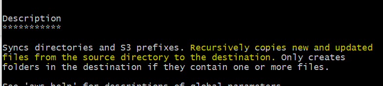

Christopher Hahn
February 15, 2021
Check this out from the aws s3 sync help page:
"from the source directory".
This tool is not designed to act on files.
