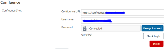

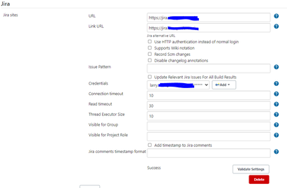

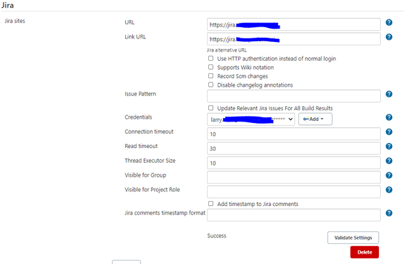

Also, I have successfully tried to connect the Jenkins to Confluence and Jira with Confluence Publisher plugin (refer to Capture.PNG) and Jira plugin (refer to Capture2.PNG) with credential of username and password.
So, it is so odd that only connection via personal access token is failure.
