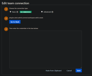

What the general process looks like is that after installing the app on your Bitbucket instance, you should get a screen similar to the following:
From here, there are two main tasks you need to complete:

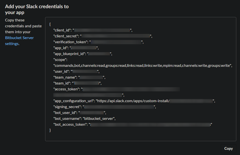

To expand on the second point - once you complete the setup of the official Bitbucket Server app within your Slack instance, you should receive a bunch of configuration data akin to the following:
This JSON is what you're going to end up pasting into that last section of our first screenshot. Once that's done - you should have successfully established a bidirectional link between your Bitbucket Server instance and Slack!

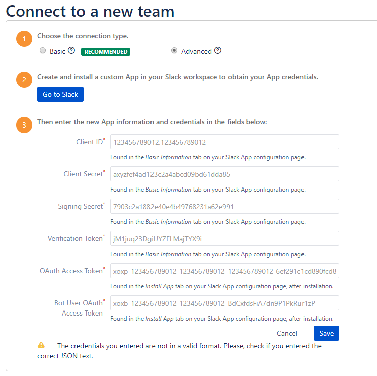

So i followed the directions here https://confluence.atlassian.com/slack/use-slack-and-bitbucket-server-together-974387205.html.
As our bitbucket is behind a firewall i then proceeded to creating an app as described
Followed the steps carefully. Skipped anything that wouldn't work if the instance is behind a firewall.
When back to the bitbucket instance and i enter my details about the app in advanced mode, i get the same error
The credentials you entered are not in a valid format. Please, check if you entered the correct JSON text
I tried this a few times now @Evan Slaughter
Since your Bitbucket instance is behind a firewall and can't facilitate this needed bi-directional communication between Bitbucket and Slack, the instructions you need to follow are going to differ significantly from the ones mentioned in my earlier response last year, as you are trying to create a custom app to accomplish this task which has since been outlined/added in the article mentioned following the submission of this original question.
All of the steps to do this should be found over in this section of the article you mentioned, instead of using the steps mentioned in this community post. If you're still having trouble after following those steps, it would probably be best to go ahead and submit those specific issues you're encountering as a separate community post to help highlight these different errors you're now receiving that shouldn't be related to this previous recommendation.

Hi,
I'm having exactly the same issues as described by Hamdy. Also with setup behind a firewall. I have been following the guide of your offical documentation (https://confluence.atlassian.com/slack/use-slack-and-bitbucket-server-together-974387205.html) and skipped the behind firewall ones. The section you referred to is a dead link so it's not reachable.
We already have a slack setup for our production bitbucket server, but I now want to configure the same for our test bitbucket server. The existing setup was done a while back via the simple method and that works fine. When trying the guide for the advanced setup for the test environment, we get the same error message as Hamdy (The credentials you entered are not in a valid format. Please, check if you entered the correct JSON text). The JSON text was provided with setup off the production environment and I'm not prompted to add it again via advanced setup. See below where the error occurs, our data removed.
