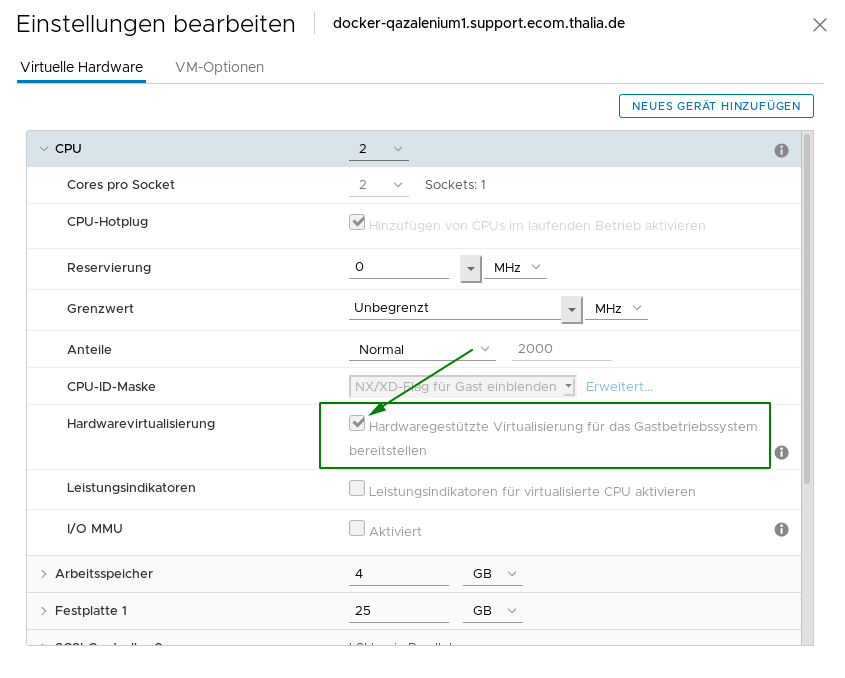

Hi Malcom,
actually this is quite easy, since there is a Flag, which can be used to update the CPU settings within VMWARE.
Hope it helps.

I think you cannot change the hardware settings on BitBucket Cloud.
Or can somebody provide a link to this setting?
