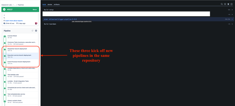

Let me share a screenshot to help explain. When I open a PR in the repository in question, the `pull-requests: **` pipeline kicks off. It looks like this.
There are three steps in this pipeline that use the aforementioned trigger-pipeline pipe to kick off three other custom pipelines in the same repository.

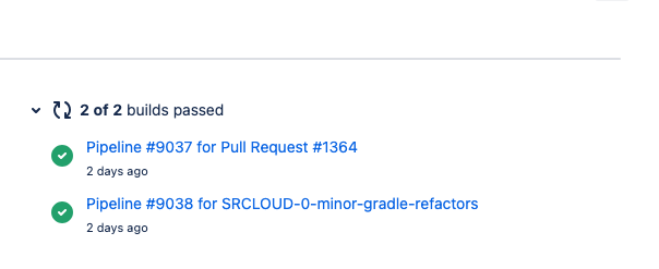

However, the pipelines card on the right hand side of the pull request looks like this:
2/2 builds, even though there are at least 4 distinct pipelines. The root one (which is 9037 in the above screenshot) and three "child" pipelines spawned using the trigger-pipeline pipe.
The feature requests you raised are definitely related, but it's not clear to me that they address the felt need here. These are 4 distinct pipelines with different identifiers. They are building against the same branch. Is there some metadata that I can add to these pipelines to make them associated with the same pull request so that they:
