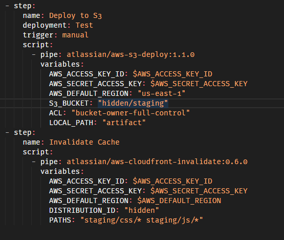

I set up all variables required but i receive this error
ERROR: Error creating a cloudfront invalidation
✖ Failed to create a cloudfront invalidation: Unable to locate credentials
I set up, AWS_SECRET_KEY, AWS_ACCESS_KEY_ID, DISTRIBUTION_ID and REGION, and received credential error

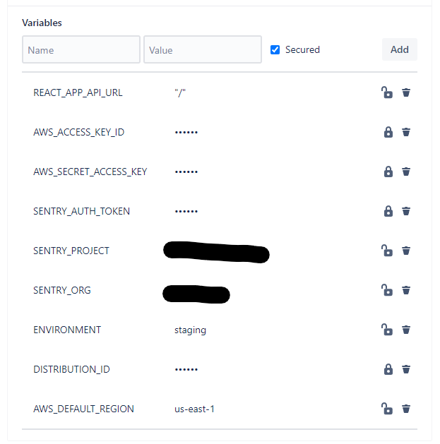

@Felipe Micheletto hi. Thanks for your question.
We need more information. Please, provide us your config details, and a screenshot of your repository variables (values should be hidden).
Alternative way to is to configure some test script in pipeline to check your aws configuration:
script:
- curl "https://awscli.amazonaws.com/awscli-exe-linux-x86_64-2.2.9.zip" -o "awscliv2.zip" && unzip awscliv2.zip
- echo 'c778f4cc55877833679fdd4ae9c94c07d0ac3794d0193da3f18cb14713af615f awscliv2.zip' | sha256sum -c - && ./aws/install
- aws configure list
 according to this guide.
Regards, Igor

The S3 deploy steps works fine, and use the same variables as the cloudfront
Igor Stoyanov
December 24, 2022
@Felipe Micheletto  just for tests. Set up in cloudfront pipe config aws region like in your s3 pipe config.
AWS_DEFAULT_REGION: "us-east-1"

@Felipe Micheletto Try to delete/add_again DISTRIBUTION_ID in the repository variables. Check in the logs this line:
If this will not help, try to call cli command inside pipeline without using pipe.

Felipe Micheletto
December 29, 2022
I Found my problem, i was using deployment variables were is not set to use, i added my variables as repository variables and everything works now! Thanks @Igor Stoyanov
