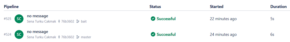

Here is an example of a situation that I encountered even though I didn't have a "default" pipeline configuration:
As you can see here, a branch called "bait" is created by me, and the pipeline is automatically triggered for #525 , with the same commit message and he same commit number from the last commit that I pushed before, #524 which is totally unrelated to #525. The only difference between them is the branch. I want to prevent #525 from happening. Is there a way for it?
