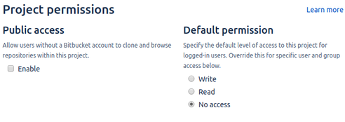

At the project level make sure "Public access" is disabled and that "Default permission" is set to "No access". Like so:
You might need to double-check those two settings are configured appropriately for each project AND repository, since repositories can override it. In newer Bitbucket versions repositories can only override the "Public access" value, but IIRC that was not always the case.

I verified that the Project permissions are set, as described above, and that the repo permissions are set correctly, but the user can still see stuff they shouldn't be able to see.
Technically, the repo permissions aren't set, so they shouldn't be overriding the Project level permissions, right?
