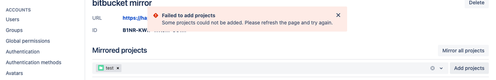

Hi,
I'm trying to install smart mirroring but get some problems.
Let me describe the scenario
Bitbucket primary: https://haproxy.com.tw
Bitbucket mirror: https://haproxy.backup.com

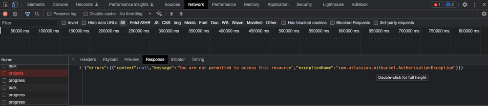

These Bitbucket use Haproxy, when the mirror successfully connects, I want to add a mirrored project but get an error.
I have tried another browser but still the same.
Refer from https://confluence.atlassian.com/bitbucketserverkb/adding-projects-to-smart-mirror-using-different-domain-results-in-failed-to-add-projects-error-1026036904.html

Hi Nat,
This will only work if both primary and mirrors are in the same domain - from the URLs you specified that doesn't seem to be the case.
Cheers,
Christian
