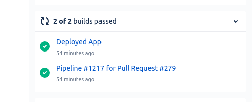

I have created a step in my BitBucket pipeline to post a custom build status "Deployed App", this is how it looks in the pull request page:

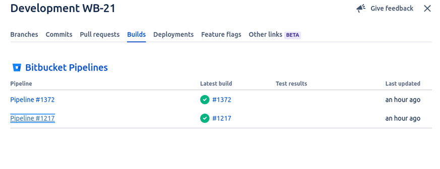

However, in JIRA when a new pipeline runs, JIRA only shows the pipeline build and not my custom build, like so:
jira_view.pngIs there a way I can display the custom build status I created in JIRA?
