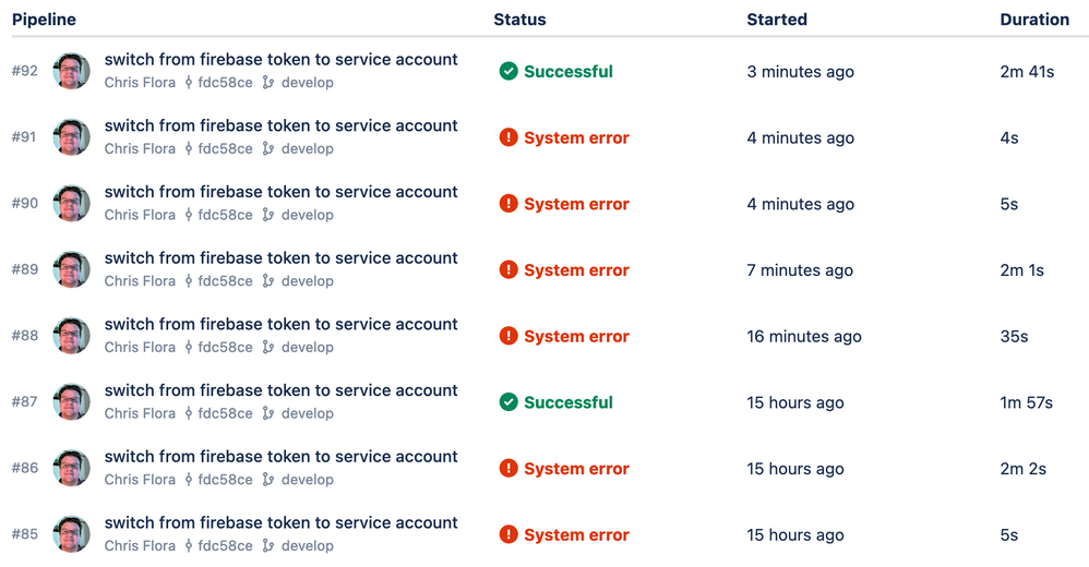

February 23, 2024
Oh, and the really fun part is that the error is intermittent.  Sometimes I get the error on the first step of the pipeline, sometimes on the second step, and sometimes not at all.  And it can vary with the exact same git commit.  In the screenshot below, you can see where some failed in less than a minute, which corresponds to the first step, and some failed after over a minute (second step):
Screenshot 2024-02-23 at 08-19-42 ctflora _ chore-chore-website Pipelines — Bitbucket.png
