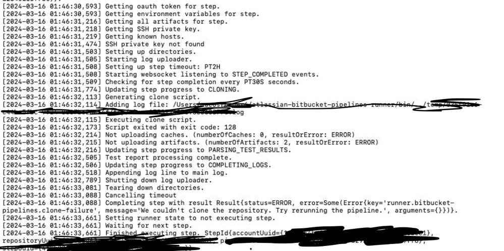

Lou Andrew Navarro
March 15, 2024
Hi, this is the full runner log output. It's failing on the clone part of the build. Any ideas what's causing this?Screenshot 2024-03-16 at 11.36.02.png

The latest log shows the following error:
We couldn't clone the repository. Try rerunning the pipeline.
I've seen this error occur with MacOS runners when a runner is stopped and then restarted because the Java process for the runner was not stopped or killed when exiting the runner. This is one possible cause for the error.
Can you please try the following:
- stop the runners
- check Activity Monitor on your Mac for any running Java processes
- if there are any, stop them from the Activity Monitor
- then start the runner again
If this doesn't solve the issue, please reach out via the support ticket you created and provide the build URL and details asked by my colleague.
