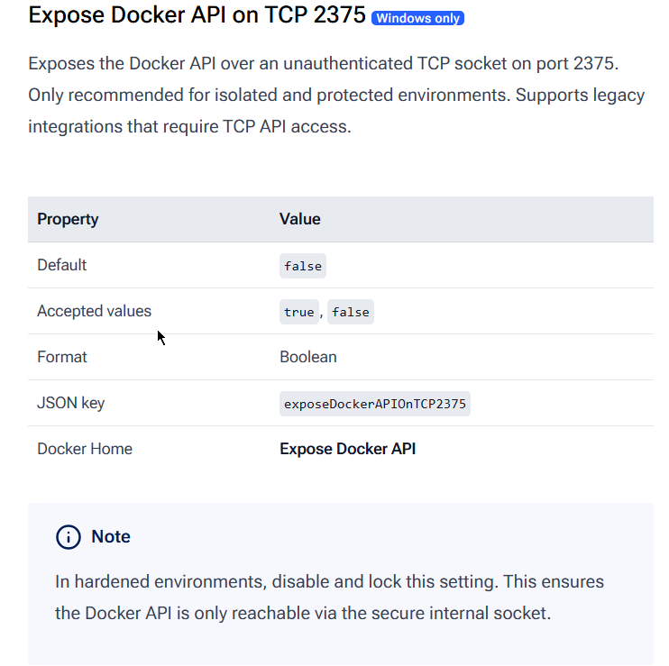

First - Exposing 2375 - is Bananas. @Viswanathan Ramachandran
This error happens because Bitbucket Pipelines automatically injects a `DOCKER_HOST` variable, forcing Docker to look for a TCP connection on port 2375 instead of using the standard Windows named pipe.
Clear the variable at the start of your PowerShell script step using `$Env:DOCKER_HOST = ""` or set it explicitly to `"npipe:////./pipe/docker_engine"`. Avoid enabling TCP port 2375 in Docker Desktop as that creates an unnecessary security risk. If clearing the variable results in a permission error, run `whoami` in the step to verify that the Windows service account running your runner actually has access to Docker.

My bad. I agree completely. I should have been more clearer. I'll just try to rule out the error and then remove again. Thank you for the mention and pointing out the reference article

All fine. I just wanna point that Exposing ports is never good idea image.png
