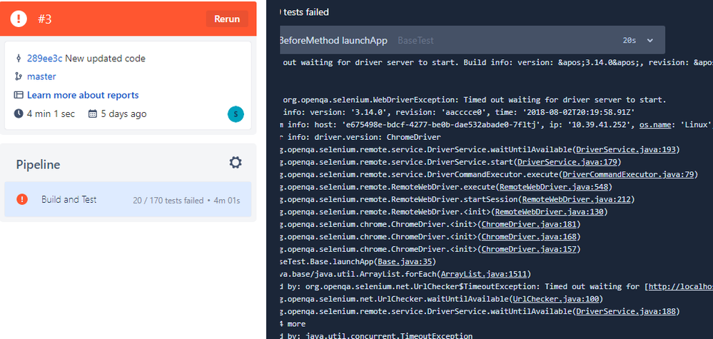

Hi Akhil,
Did u get an answer to this or have you resolved this? Please let me know. I am facing the same issue related to driver timeout. I have posted my question in Atlassian community. Please check once. Below is the link to it:
