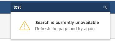

Search dosen't work at Bitbucket
netconomyadmin
April 20, 2018
It looks like Elasticsearch dosent't work after upgrade from 5.3.1 to 5.9.1.
We have restart the Server often.
The config is the same.
Please help
