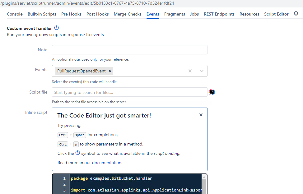

I am trying to create an issue in Jira when pull request is created in BitBucket:
So I've borrowed code from here and adapted it to create task in Jira, but task is not created. I double checked the name of the project and type of task to be created.
Code is not throwing any exception and pull request is correctly created.
My code looks like this:
