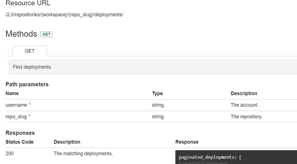

/2.0/repositories/{workspace}/{repo_slug}/deployments/
If my workspace is "saman"and repo_slug is "project1.git" then url will be
/2.0/repositories/saman/project1.git/deployments/
Is it correct?
It is not clearly mention in the document too. It says path parameters are username and repo_slug. and description of username is "The account."
