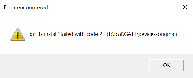

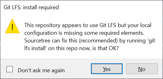

Now, when I go to clone the repo, I get this message:
and when I click Yes, I get:
image.pngSo I open a terminal window and enter git lfs install manually and the hooks are added.
