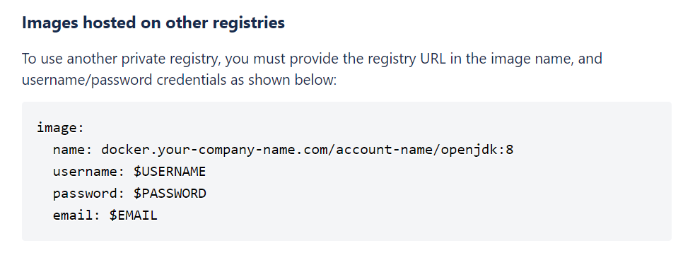

We had this error message:
There is a problem with the format of your docker image name at [image > name].
We tried to have image set like this:
 You should at least update the documentation here:
https://confluence.atlassian.com/bitbucket/use-docker-images-as-build-environments-792298897.html
image.pngWith this information:
The image name does not support having environment variables.
