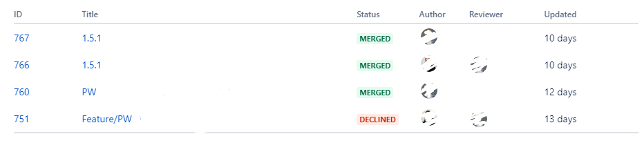

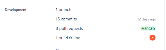

Necessary remove the display of the build status of the declined PR from the JIRA task.
At the moment visible, all build statuses.
There was an assembly with an error, after which the PR was declined.
It is necessary to display only the build status of not declined PR from the JIRA task.

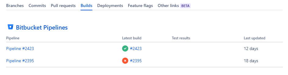

The Builds tab of the Development panel will show the latest Pipelines build that ran for a branch that includes the Jira issue key in its name.
I'm afraid that it is not possible to filter which builds will be displayed in that tab.
