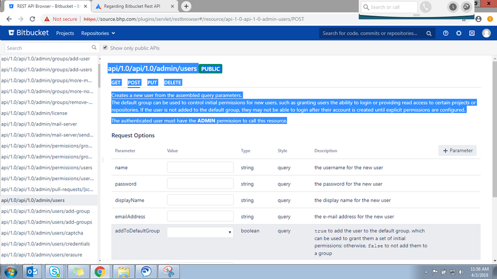

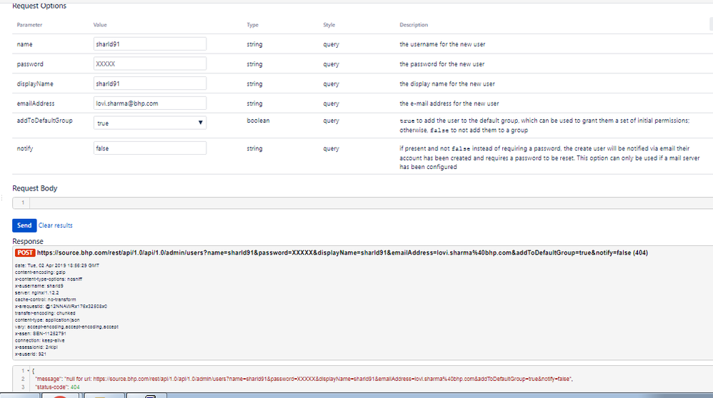

error.PNGHi Team,
Getting the below error when ever am posting any content on rest API.
The same error comes when i post using curl too.
Need your urgent help in resolving this.

Hi @lovisharma ,
Perhaps you should review your REST API call https://source.bhp.com/rest/api/1.0/api/1.0/admin/users?... as there is a duplicate (api/1.0), instead, please try https://source.bhp.com/rest/api/1.0/admin/users?...

lovisharma
April 2, 2019
Hi Rafael,
This URL which is coming from the REST API BROWSER. Even if am using CURL for posting the content on https://source.bhp.com/rest/api/1.0/admin/users? (its giving me the same error.image.png
In every URL api/1.0/api/1.0 is repeating.

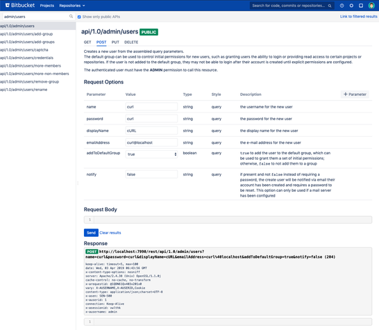

The /api/1.0 duplicate might be caused by a redirect on your web proxy, incompatible plugin or something else. As you can see not only from https://docs.atlassian.com/bitbucket-server/rest/5.16.0/bitbucket-rest.html but also from screenshot below the duplicate seems to happen only on your environment.
