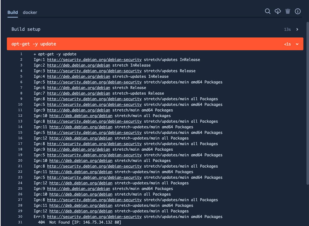

Recently Pipeline apt-get update Fails
Neha Verma April 24, 2023
Here is my Pipeline file
This is the error I am getting

Hi @Neha Verma,
Just to add some additional information here: I don't think that the issue is related to the version of node, but rather to the version of Debian that this Docker image uses.
The Dockerhub image node:12 is using Debian 9 which is considered EOF (End-Of-Life).
You can see the version locally if you have Docker installed on your computer. You can run the command
docker run -it --entrypoint=/bin/bash node:12
In the bash prompt of the container that starts, you can run the command
cat /etc/os-release
This will show you that the image is using Debian 9.

Neha Verma April 26, 2023 edited
Hi @Theodora Boudale ,
As I have checked, Debian Dockerfile has stopped the support for node tag 12 image because of that I guess I'm getting the error once I changed the tag from 12 to 14 which the last version supported by the docker file of node worked fine for me.

Theodora Boudale
April 26, 2023
Hi Neha,
Thank you for the update. I see that the Dockerhub image node:14 is based on Debian 10 (while node:12 is based on Debian 9), which is why there are no errors with it. I'm glad that this works for you, please feel free to reach out if you ever need anything else!
