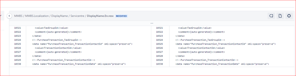

Sometimes, a pull request diff will contain files that are actually modified but the changes doesn't appear in the file viewer.
In this screenshot, the line 10331 contains the actual change, but the line is not visible.
Also, note that there should be a bottom line showing "..." (like the line on top of line 10321) that you can click to inspect the code further down, but it is not present.

Hello Rodger,
What you are seeing is the bug https://jira.atlassian.com/browse/BSERV-12309. You would just add something like the following to your bitbucket.properties file and restart Bitbucket to work around the issue.
page.max.diff.lines=15000
Keep in mind that doing this can cause some additional load as Bitbucket is now attempting to load more lines of the diff. But this should work around the issue while we work to resolve it. :)
