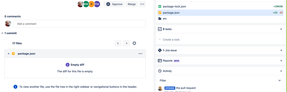

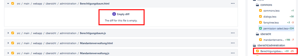

Lately Pull-Request-View is showing files as "empty diff" on the left while correctly reporting the number of added / removed lines in the files tree.
Same problem in "old" Pull Request view.
Is this a known Bitbucket Bug? Is there a workaround to get the correct diff?

I've started to have this problem too since today.
In my case I couldn't see the diff in any pull request, even older pull requests that were already merged.
In my case I saw that I can't see the diff as long as I have the "TikTok Pixel Helper" browser extension is enabled.
I'm not sure why it stopped working today, because I've installed that extension a few months ago.
As long as I keep that extension disabled I can se the diff.
So check your browser extensions, maybe there are other that can break displaying the diff.
Edited:
As @natashabates suggests below another solution is to set "This can read and change site data" to "When you click the extension" for the "TikTok Pixel Helper" extension.
Tammy Keefer
March 30, 2023
Same.  Disabling the TikTok Pixel Helper extension solved my problem.  So thank you!  If that extension isn't your problem, I was also able to see the diffs if I was in an incognito window.
nick.mcphedran
March 30, 2023
Amazing thanks @Ionut - I would never have worked that out.  But I was having the exact same issue - everything worked fine yesterday but today I was just getting:
Empty diff
The diff for this file is empty.
Disabled the Chrome TikTok Pixel Helper, and now works fine again!  So odd, but thank you!

June 7, 2020
I am also getting this same error "Empty Diff".
Any ideas to root cause / fix?
