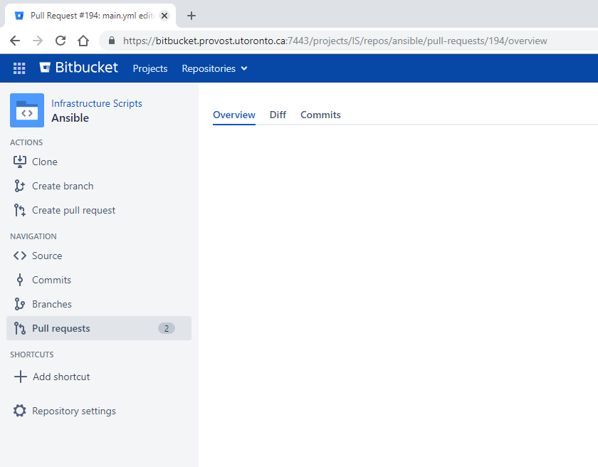

After we upgraded to 6.0, all pull requests we make are now blank.  All three tabs are blank.
I am seeing errors in the console, but I don't see how they would make this screen empty.

Thank you for providing a screenshot into what you’re seeing on your end with the blank pull requests.

First is the following KB which is similar to your issue: Nothing displayed on the pull request page. The resolution within that article is as follows:
The only solution we know currently is by disabling and re-enabling ALL the plugins in the Bitbucket Server instance. Enable "Safe Mode" to quickly disable the plugins.
We've also observed this problem being caused by a third party plugin called Bitbucket Server Webhook to Jenkins. We used to recommend you disable this plugin. Be aware that now the provider has updated the plugin to fix this issue. The details are described in the "Version History" tab of the plugin page and a customer has reported to us that the issue is solved.
Ultimately, if that does not solve the problem, please open a support request at https://support.atlassian.com attach a Support Zip as well as the the console output from the web browser e.g. open the *JavaScript Console* in Chrome (Settings > Tools > Developer Tools and click on the Console tab, reload the PR page).

We actually found the issue.  It was a plugin for automatic Jenkins builds.  That plugin wasn't compatible with 6.0.  They've since released an update that works.
