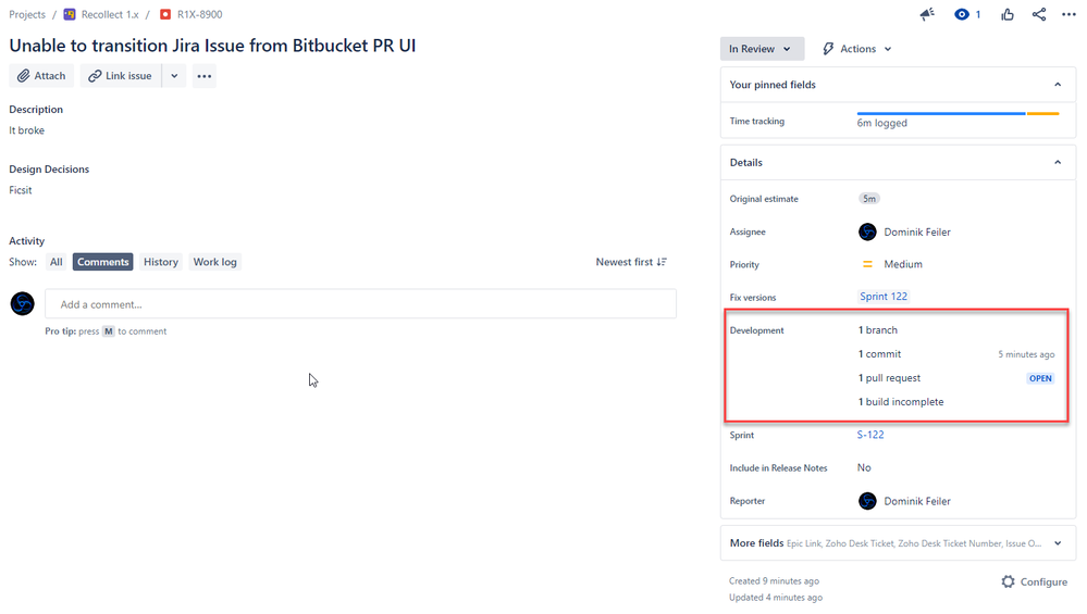

I can see that the link to the issue is established, because in the Jira UI I can see
1 Branch
1 commit
1 pull request

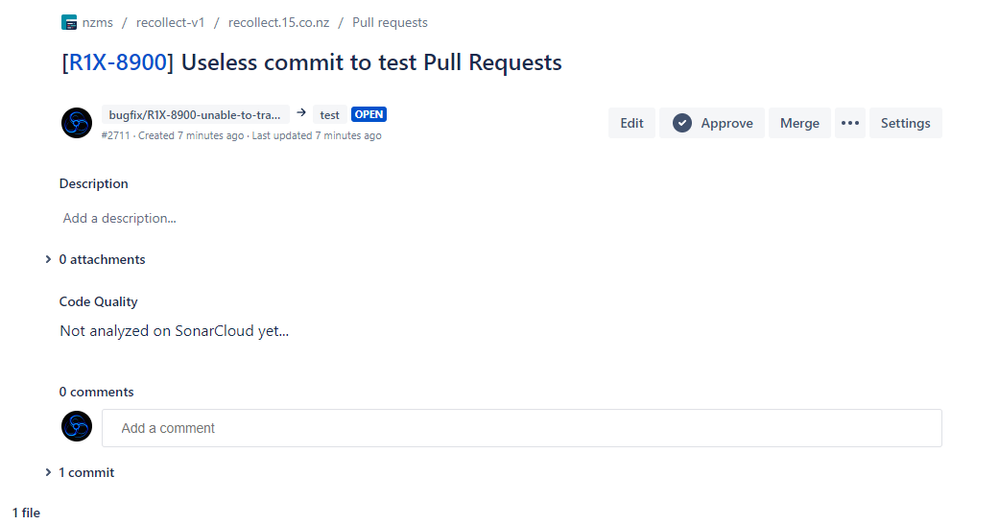

Likewise from the Bitbucket Pull Request UI the Jira ID is hyperlinked in the Pull Request title and clicking it brings up the correct Jira ticket:2023-04-20_16-14-32.png

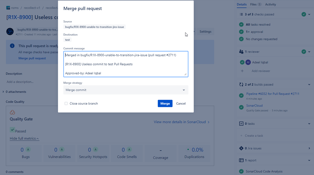

However, now the option to select the 'destination ticket status' has disappeared:
Thanks for chiming in if you have any ideas what would cause this to drop off.

From the screenshot you have shared, I see that the Jira issue side card on the Pull request page was showing 0 Jira issues, even though the Pull request was correctly linked to an issue key.
We were tracking a bug (BCLOUD-22595 ) where the issues were not appearing in the pull request side card even when a Jira issue was linked in the PR's commits/title. I suspect that the transition option not appearing when merging a pull request is a side effect of the bug above.
Our engineering team has recently deployed a fix for this bug, so the newly created pull requests should not be affected by this. Could you please try creating a new Pull Request, with an issue key linked to its title, and let us know if the transition option is still not showing when you merge that Pull Request and also if the linked issues are showing in the Pull Request Jira side card?

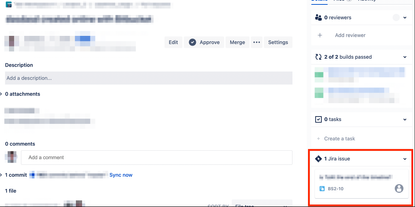

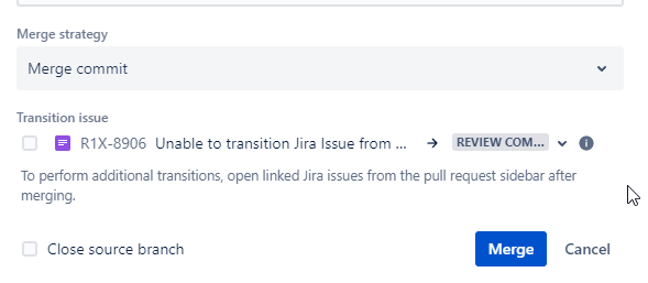

Dominik Feiler
April 23, 2023
Hey Patrik, thanks!
I can confirm the Jira issue now shows as linked and the transition is working again.
Thanks for resolving this so quickly!
