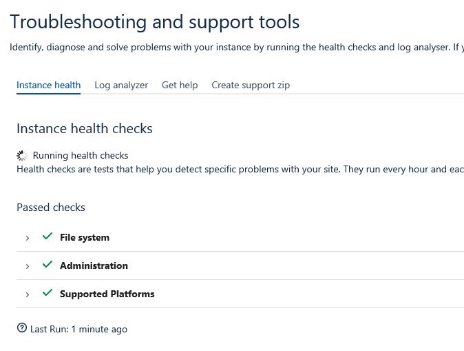

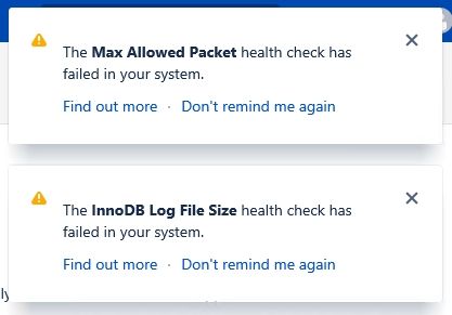

Hello, l'm yunju.
l've done the installation via confluence and linking with mysql5.7.
I'll share the configuration environment once.
There are 5 total servers, JIRA / Confluence / Bitbucket / Crowd / DB Server.
Currently there are no errors on Jira, Bitbucket, Crowd, and only on Confluence.
I do not seem to recognize my.ini,
innodb_log_file_size = 2048M
max_allowed_packet = 256M
The currently configured my.ini looks like this:

I can not find these two values. So if you go to trouble shooting, it will not load. I'll attach the log and capture bones.
Please do it soon.
Thank u

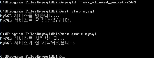

Yunju Jung
May 15, 2019
Currently running os is window.
And after applying the parameters, I restarted it again because I did not restart it and reinstalled it.
I applied and applied the URL I sent, but my.ini is already applied
mysqld --max_allowed_packet = 256M in the shell. I also restarted the Confluence service. But the problem of trouble shooting still seems to be. Is there any other solution?

Yunju Jung
May 15, 2019
Sorry for the confusion :(
The problem's not resolve yet.
Troubled shooting, like capturing, shows that loading is not complete.
Andrew
May 15, 2019
Not sure You correct added parameter in console.
Where placed your my.ini? For example I have C:\my.ini and C:\my.cnf.
my.ini should be equal to my.cnf. And then try restart service.
B.R.

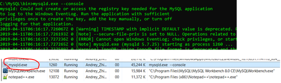

Andrew
May 15, 2019
C:\..>mysqld --max_allowed_packet = 256M
I'm afraid than it run mysqld.exe process, but 'net stop mysql' might not stop process.
I recommend use only one way to run mysql: 'service' or 'cmd'.
For example I use only 'cmd':
Could You please check process.
B.R.
