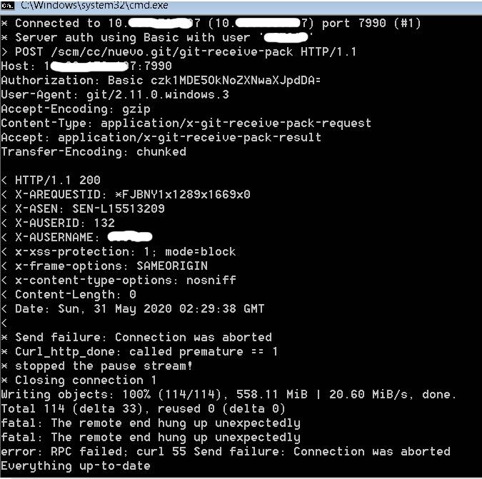

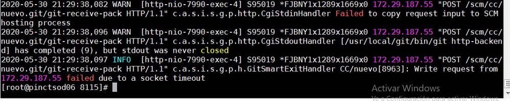

Please where could I modify the timeout parameter in bitbucket
Have the following problem:
I want to push a new 700 mb project and I get the error
Nic Brough -Adaptavist-
May 31, 2020
The timeout is not the problem, it's your server not being able to do something
You'll need to read the logs and analyse them to work out what the server is doing that is taking so long.
