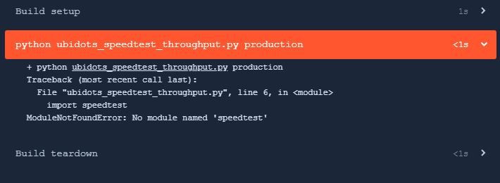

I've got a pipeline that I'm trying to do some cloud testing with.
It's running Python, and the very first step installs the dependencies that I need to run the rest of the .yml file.
Yet, when it gets to the next script, it says it can't find the module that it just installed. I've run this same script (with the exact same syntax) on hardware and it works. Is there something to Bitbucket Pipelines that I'm missing? I've read the documentation on configuring Pipelines, both in general and specifically for Python, and it's running the exact same version as the hardware I've tested these same scripts on.
The script that's running is prefixed by #!/usr/bin/python, if that helps.
Is there something integral to Pipelines that this messes up?

Daniel Disbrow
October 8, 2018

The error I'm getting is on step 2, which is that the speedtest module doesn't exist.
Not using Docker in any part of the installation. Why would debugging with Docker help?

The bitbucket-pipelines.yml looks fine to me.
Can you double check that the files exist in the directory you're expecting to find them in? The following 'ls' commands should suffice.

Daniel Disbrow
October 9, 2018
They come back in the right directory, but there's an internal command within the files themselves that I'm having issues with that's coming back with this.
